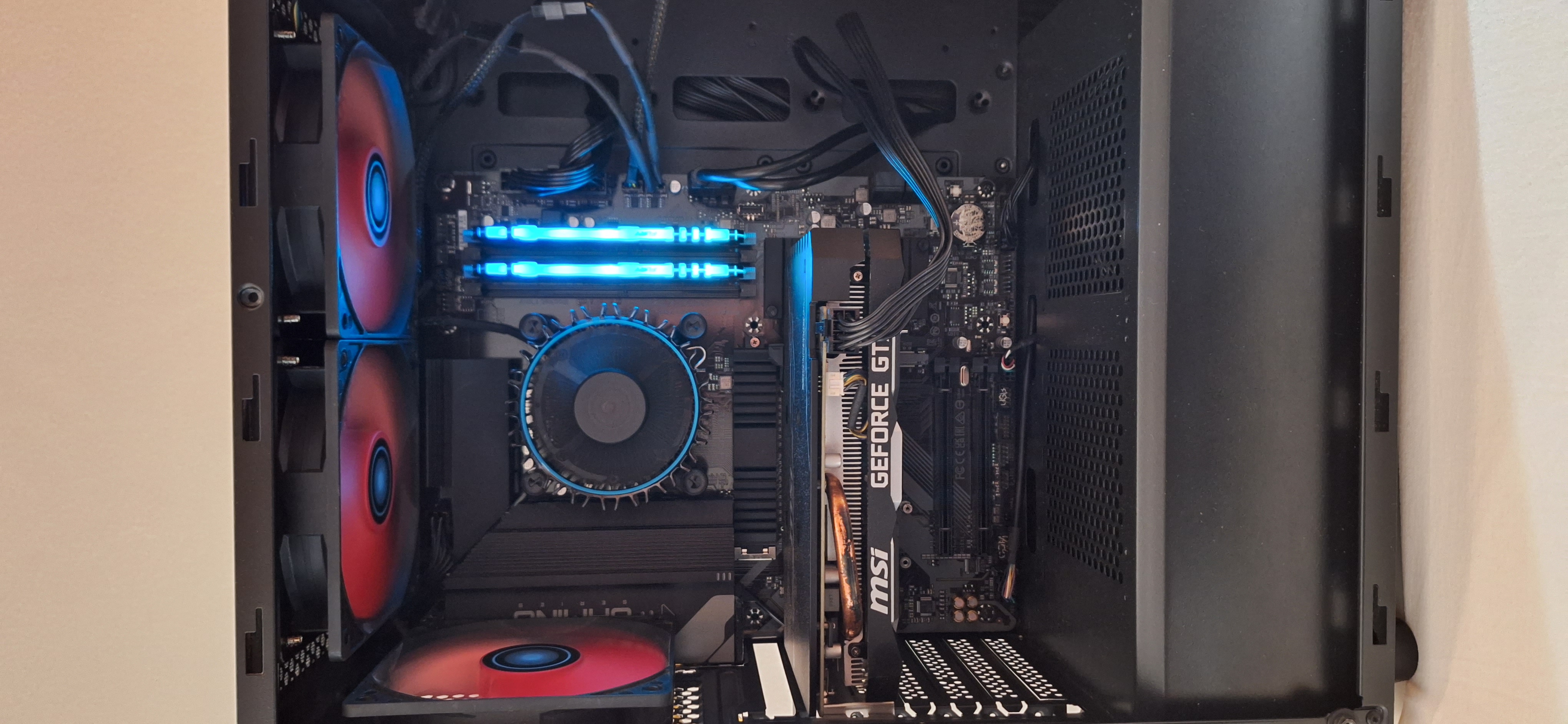

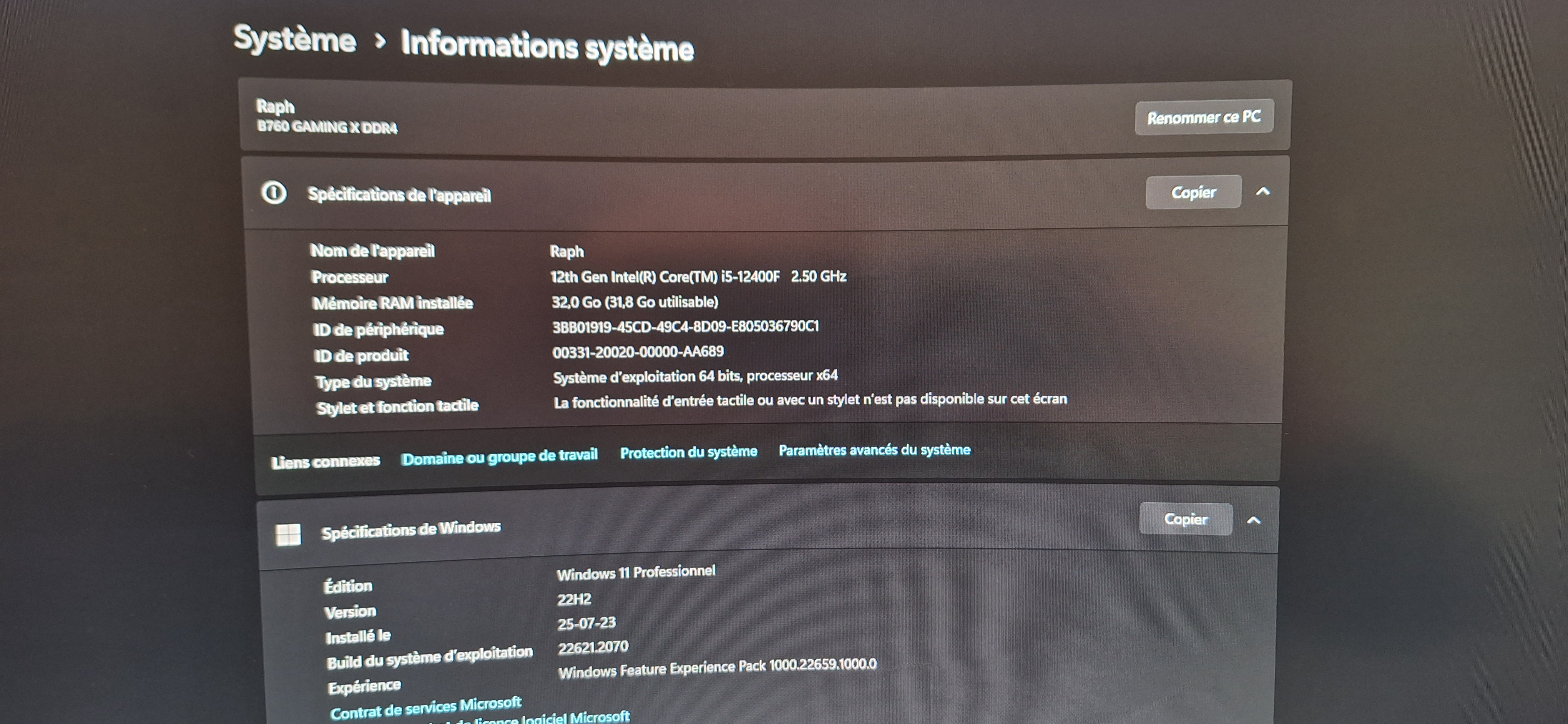

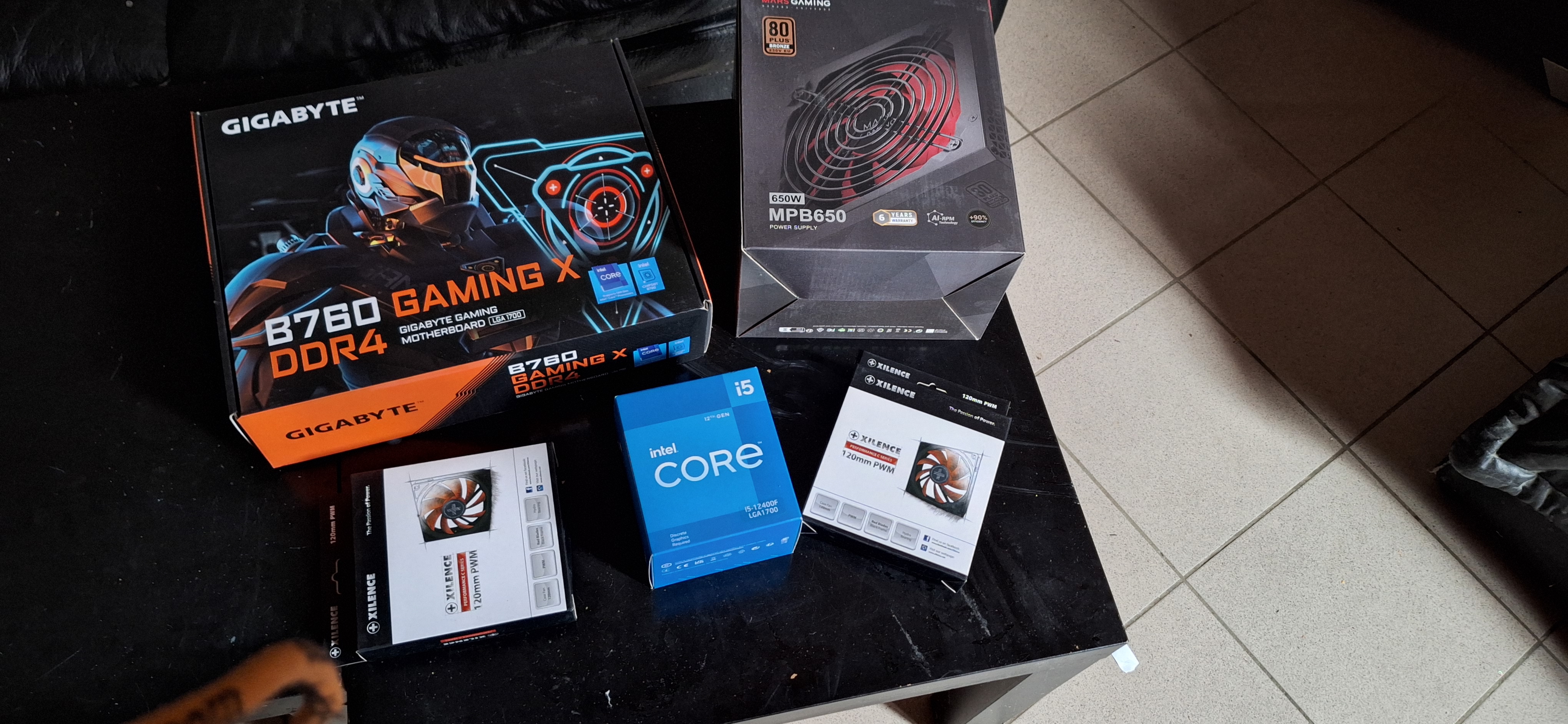

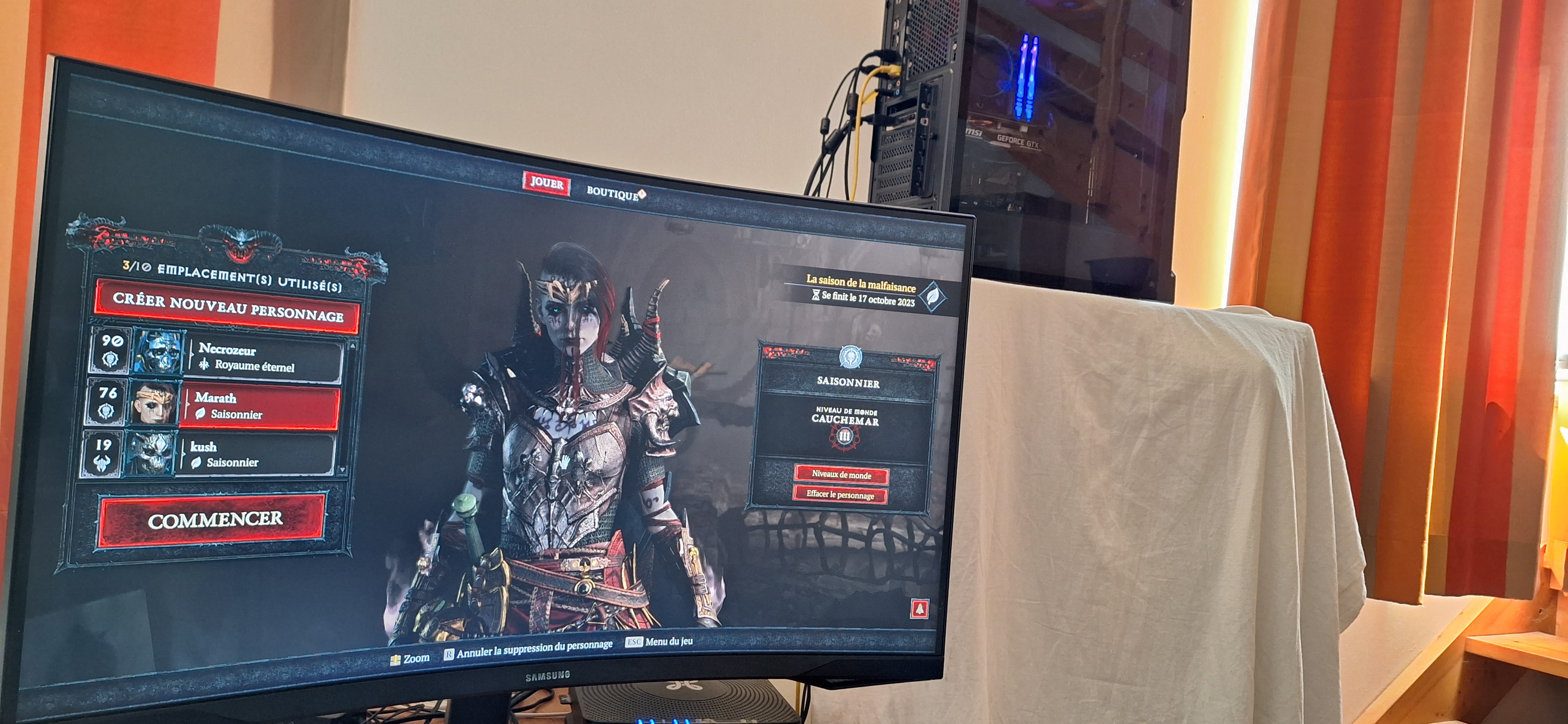

 Raph
(@raph)
Messages: 9
Voici mon petit set up
